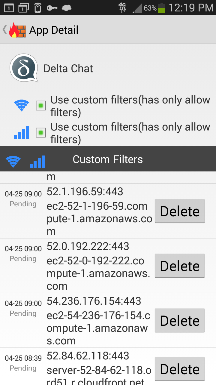

I upgraded DC to 0.301.1 and at first app start, it tried to connect over encrypted channel to some amazon servers. After exploring a little I found new feature “On demand location streaming” that was turned off. When I turned it on, phone start making more connections to unauthorized locations. I’m guessing that new feature using some 3rd party services. Ok, I turned it off, but DC still attempting to establish connections to unknown IPs which rise a question - is it a bug or end of privacy?
Why DC trying establish connections to unauthorized IPs even feature above is disabled?

when the experimental location-streaming is turned on, the is an option to display a map. the tiles of the map are downloaded from a server; we use Mapbox for this that seems to host tiles on amazon then.
the location stream itself is not sent through mapbox, these information are sent through mail.

But as I said, this “experimental location-streaming” was turned off when I started DC after upgrade, but DC tried to establish connection anyway. After I played a little with this new feature, I turned it off for sure, but DC still attempting to contact Amazon servers, not too often, but it does that make me feels like a rat in someones research laboratories.

wrt to the connection to some cloud servers: they definetly do not come from “our” source, however, might be mapbox. mapbox is also open source - maybe someone can investigate here a bit further, what we can do to prevent this, when it appears, maybe file an issue on mapbox and/or deltachat and so on @AlexJ are you up for that?

i’ve tried to target this issue by https://github.com/deltachat/deltachat-android/pull/886 and changed the title to match the issue.
we’ll see if that works, @AlexJ i’ve uploaded an apk with the changes at https://share.riseup.net/#TbsPaPSA7ZGTJGfzBJiGKg - would be great if you can test this.
EDIT: also 0.303.0 is on the way that includes the pr

the current code (0.303.0) tries to disable this behavior, see init mapbox only as needed and disable mapbox-telemetry by r10s · Pull Request #886 · deltachat/deltachat-android · GitHub
assuming mapbox respects this setting, the only data send are the requested tiles then.

No, my firewall catching connections per application, it wasn’t browser or something else and “location streaming” was disabled by default on upgrade, but DC tried to establish connection to amazon.
I think it fixed in 0.303, thank again to Björn !
