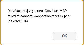

Error 104 connection error
Hello! Please help me solve this problem. My posteo provider. I tried to send a file weighing 100 megabytes. My ISP is missing 50, I just forgot that. After this an error occurred. I deleted my account and am trying to log in again. It gives this error

I use Linux system Triskel. My email works by itself. I can send and receive letters. But I can’t enter delta chat and it gives an error. I clicked delete account in delta chat, hoping to try to log in again, but nothing happened.

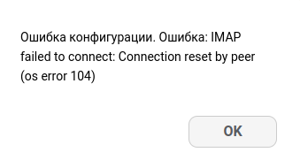

So I try, it gives an error.
I don’t know why you still get a configuration error.
