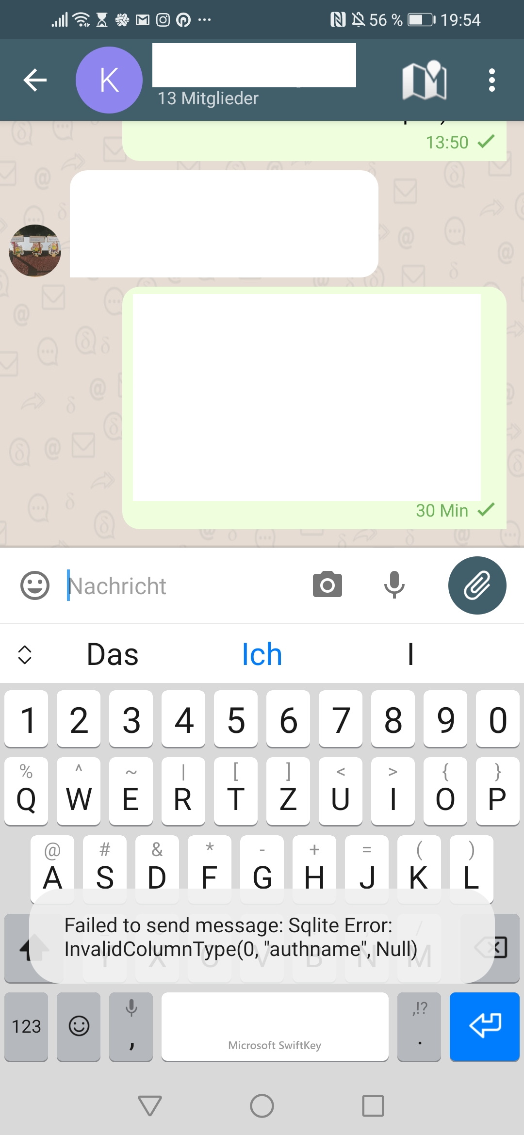

When I want to send a message in a group, the message gets send to every group member.
On Android: An error appears and the message is not send. Some seconds later, the message appears and a circle is shown, that seems to say, that the client is trying to send a message, but it doesn’t work. On windows sending works without problems.
  1. I type in a message
  2. I send it
  3. An error appears (see screenshot)
  4. Message appears with a circle, that shows, that the app is trying to send it.

From the log @Christoph sent per email:
W DeltaChat: src/chat.rs:862: chat: failed to load peerstates: Sql(InvalidColumnType(1, "addr", Null))
E DeltaChat: Failed to send message: Sqlite Error: InvalidColumnType(0, "authname", Null)
This looks like a broken database to me, so to solve it I would suggest to import an backup from your desktop. But please make a backup from your dc on your phone before doing that so if we have further questions about this bug we can still ask you do check things in the database, I won’t ask you to share the database with me, because it contains too many of your secrets, like your private key.

I have now imported a backup and now it seems to work on android again. Thanks for your help.
