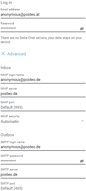

To make the issue more understandable: People like me who are forced to use an alias address (e.g. ending with “.at” instead of “.de”) cannot log in unless the unique user ID is entered in the “Advanced” section. The default values in there are those for SSL security. Although Delta Chat can connect to Posteo with SSL just fine, it is neither recommended from Posteo nor does it match the respective parameters from the internal provider database. This could lead to a lot of wrong configuration setups every time a mail alias becomes part of the game…

I think I should explain how users with a mail alias would deal with the situation:
  • Entering alias address, and password, result: bad login credentials.
  • Entering alias address, and password, expanding “Advanced”, and entering the real address (user ID), and password (for SMTP), result: ready, but SSL is used.
Instead, for users without alias address:
  • Entering address, and password, result: ready, and STARTTLS (recommended by Posteo) is used.
My concern is: Users with alias address would not think about changing port and security values as well, they just try and succeed, that’s it. They would not know about a wrong configuration unless anything does not work out right. This could be avoided by Delta Chat, by considering the parameters stored in the provider database.

When I use my alias address (".at"), I must expand “Advanced” where SSL values are set as “(Default)”. I know of course that these are not default for Posteo, so I must change them accordingly. But who else is about to know that? Most people would check out the (wrong) default settings and see Delta Chat works fine, that’s it.

Sometimes one picture says it all:
