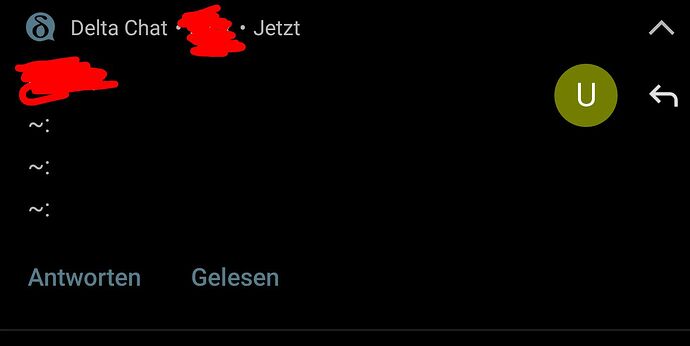

Here is a screenshot of the notification area using the location service. The mobile phone is vibrating often, too. Apart from that the location service was very useful :+1:
