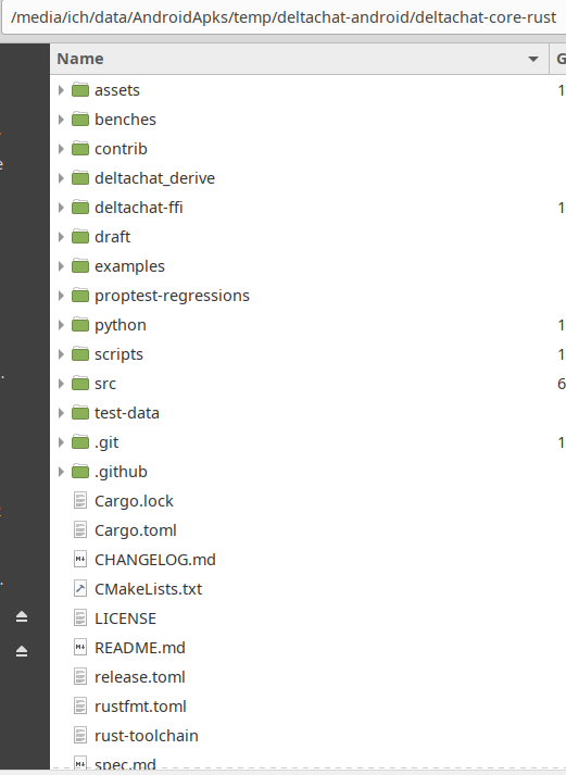

both scrips are inside /ndk-make.sh’ folder deltachat-android and not in core folder. so the command ‘/ndk-make.sh’ have to be executed in folder deltachat-android and not in core folder. right ???
