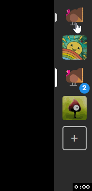

Accounts Can be ordered by dragging and dropping
A “denied” symbol appears when trying to drag an account:
  1. Just try to drag an account avatar in the left sidebar, down or up.

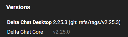

Open the _Settings_ menu -> _About_ -> _version number|Info_.
Not sure this is what you mean with debug logs..:
