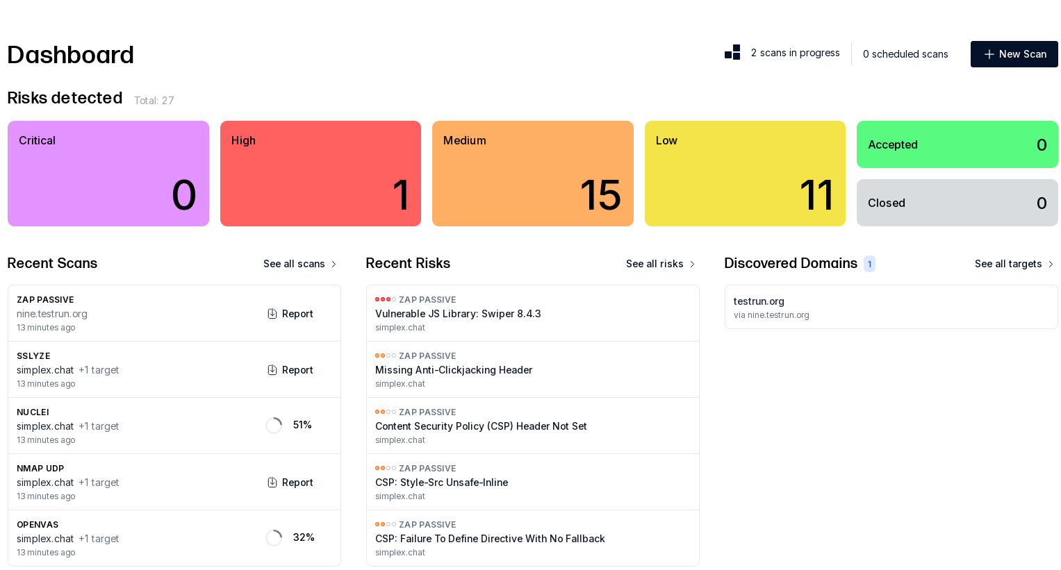

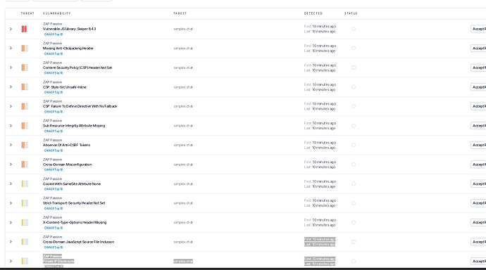

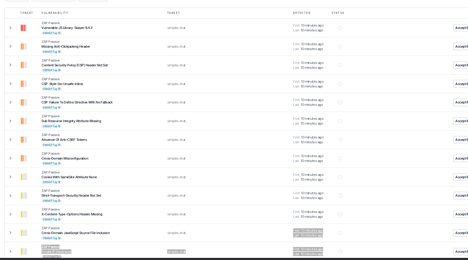

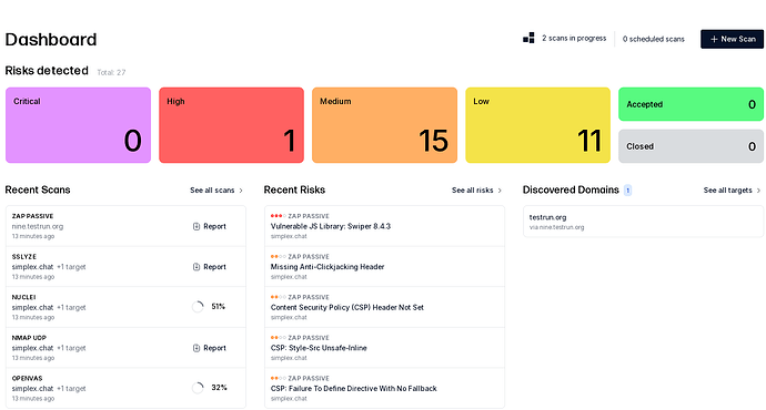

I wouldn’t uses simpleX considering they cannot even maintain their website without putting user security at risk. If they cannot updates known outdated and vulnerables resources. It shows how much they are aware of their own metadata and data.
The App is so fucking noisy for anyone that would sniff or perform deep packets inspection such traffic would gather his attentions. Everything is noises until you break it down.
It also facilitates social engineering so much.
they are not even compliant with the “lowest/most basic” security standard such as owasp .
