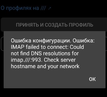

"Could not find DNS resolutions for imap.///:993" when adding a relay
Hello! So i’m trying to setup a local relay in a heavy internet censorship area for personal needs.After following the guide, I can successfully register and use a profile using my relay, but most people end up with this issue:
IMAP failed to connect: Could not find DNS resolutions for imap.///:993. Check server hostname and your network
The worst part is that I cannot reproduce it in any way and have no idea where the issue is, but I suspect it’s something really obvious and silly.

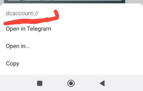

I found the issue and it was silly indeed. I was using Telegram to send index.html link to friends and Telegram has a previewer function to open links with it’s own browser - that browser is shit.
It removed the link for some reason and therefore Delta Chat was trying to connect to nothing.
Solution was to open it with a normal browser.
Don’t use Telegram to open delta chat invite links.
