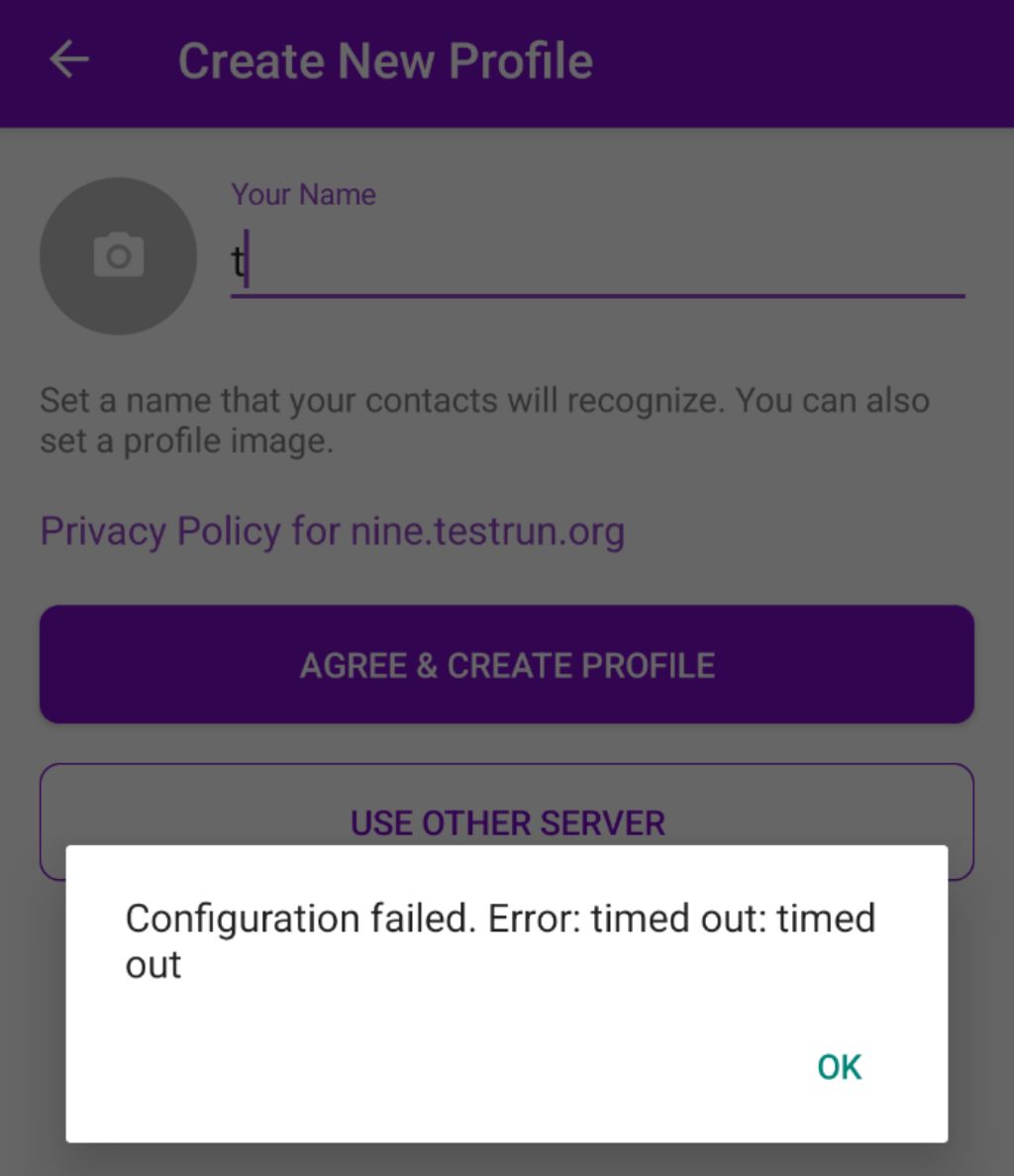

it is stuck at 60% for several seconds then it just display this dialog:
and there is no way to get the logs there, I think that dialog should have an “open logs” button
Is it possible to get it with adb logcat? It should have individual “failure” and “success” logs printed for each attempt.

and there is no way to get the logs there […]
you can access the logs during onboarding at “Classic E-Mail Login / Advanced / View Log”
if it is about “Create New Profile”, i would more think about a three dot menu, as we have already for “Add Second Device”. Meanwhile, as the FAQ have improved, we could also link that. but that is offtopic, let’s discuss this elsewhere

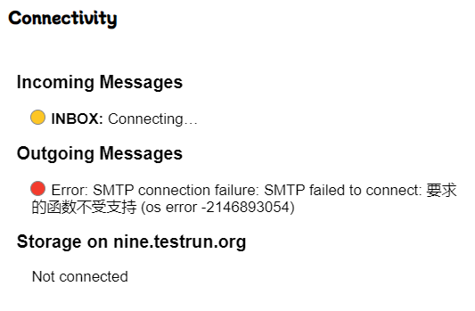

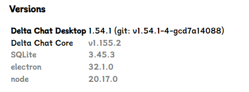

Recently, I have been unable to access it again. Here are the logs and version screenshots. I’m not sure if it’s due to my version or my network issue?
2025-03-07-10-32-33.txt (8.9 KB)
“os error 10054” on port 443 means the connection is likely blocked with TCP RST packet.
Does the website https://nine.testrun.org/ open?
Can you create an account on other chatmail servers listed on https://delta.chat/chatmail ?
Does it mean that my port 443 is blocked by the firewall? But I can use the Deltachat account of mehl.cloud, which implies that the port 443 of nine.testrun.org is blocked by the firewall? Is my understanding correct?
https://nine.testrun.org is accessible without any issues, and I am able to successfully create and use a new account. So, is there a problem with my account? :rofl:
