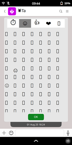

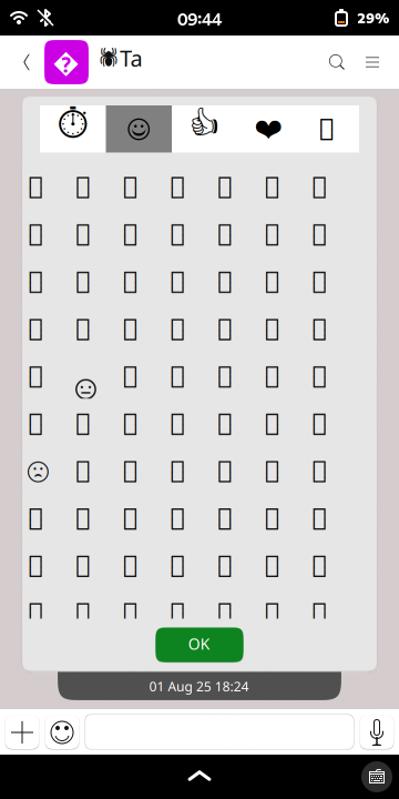

Fewer of the emojis are rendering in chats; there are two smilies, neutral and frowning, for instance. I think this change happened at the 2.8-2.9 transition. Maybe I am missing a font dependency? But some of the missing emojis were still rendering in profile names for a day or so; they have now stopped. No emojis render in avatars (if prefixed to a profile name as in the image).

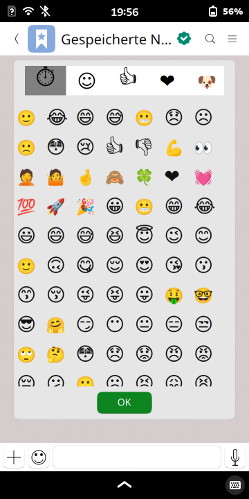

I am not aware that I changed something regarding fonts or emojis. Did you update the system around that time, too? It’s strange that so few emojis render for you. This is how it looks like on my pinephone with mobian:
I’m not sure whether this is a thing in the system font configuration or something that can easily be fixed in the app itself without shipping a complete font. I dimly remember that I had this problem when running the app on Debian. I did something like similar to [SOLVED] No colorful emoji with fontconfig 2.15 / Applications & Desktop Environments / Arch Linux Forums, but I don’t know anything about font config, so better not follow my advice here.
In any case, I’ll put looking into emojis on the todo list, but won’t be able to work on this soon.

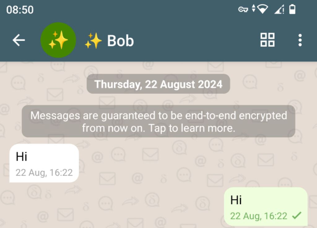

Yes, that was not handled well by DeltaTouch. It has been fixed now: #65 - correctly render emoji as text avatar if name of chat/contact starts with emoji - lk108/deltatouch - Codeberg.org
If you want to, you can install the version that contains the fix: https://codeberg.org/lk108/-/packages/generic/deltatouch/pr65/files/3728356

Thank you for the emoji-avatar fix, it looks like it was a bit of a nuisance.

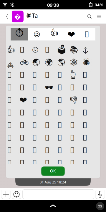

Some of the emojis in the image below are black and white. Theses are the ones I used to have. Some are colourful. These are the ones that were not rendering for me.

I now have only a smaller set of black-and-white emoji. All the other programs on my system use the Noto Color Emoji font as configured; Deltatouch is overriding that config.
The black emojis that I do have do not seem to match those of any font on my system. The larger older set might have matched the emojis rendered by DejaVu Sans.
The potted plant emoji is fairly distinctive. The ones here on the forum look like those from Twitter’s Twemoji font, with a less reddish pot:
:potted_plant: :potted_plant:
My system renders the Noto potted plant except on DeltaTouch, where it renders as two black stems which may represent a ZZ plant. I have not yet identified that ZZ font.

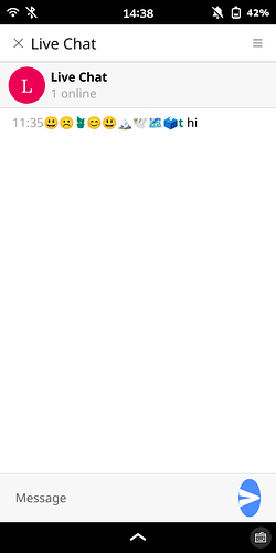

I should post this, actually; this screenshot is inside the “Live Chat” app. A profile name contains an absurd number of emojis, and the app renders them all. It renders emojis that render as tofu in the emoji-picker menu, like the smiley faces. While all the emojis that render in the picker (like the mountain, dove with olive branch, world map and ballot box) render in black-and-white in the picker, they render as full-colour Noto emoji in the app. The potted plant, which was in the picker in the previous version but which I can’t see there now, renders in monochrome green, emphatically not the Noto rendering.
The screenshot is 2.9.0, but the same emoji rendering happens in 2.12.0. I cannot explain all this. Sorry.
Emojis can contain modifiers, for example to represent skin tones. It could be that the emojis in question could have modifiers in theory, but don’t have in your case. Some systems may then render them black and white, while others may use the default modifier. In the Live Chat app, it’s rendered by Qt’s WebEngine (which is a patched Chromium, unfortunately), which may have different default rendering than the QML components of the main DeltaTouch app.
But that’s just a guess. I’m afraid I won’t have time to look into this for the next weeks.

  1. Some emojis that do not render in the emoji picker, nor in messages, nor in avatars, render in the sender-dateline under received messages, in avatar-color monochrome-and-white (such as smilies and the potted plant). The emojis that render in the emoji picker render in the sender-dateline. Nothing there renders in Noto.
  2. In Live Chat, switching to Squeekboard’s emoji layout and typing :thinking::partying_face::face_with_raised_eyebrow::nerd_face::broccoli: renders as 樂拾廊邏復.
