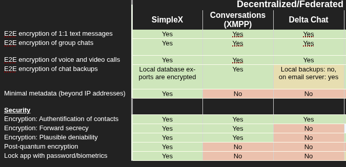

In the comparison with other instant messaging apps in Comparison of Instant Messengers , DC appears lacking some security issues such as Forward secrecy and Plausible deniability, which many other satisfy. Could they be solved?

As I understand it, there is nothing stopping Chatmail from implementing deniability.
If we had deniability, a malicious client that doesn’t respect deletions wouldn’t be nearly as bad. Since we don’t have deniability right now, malicious clients are a serious issue.
