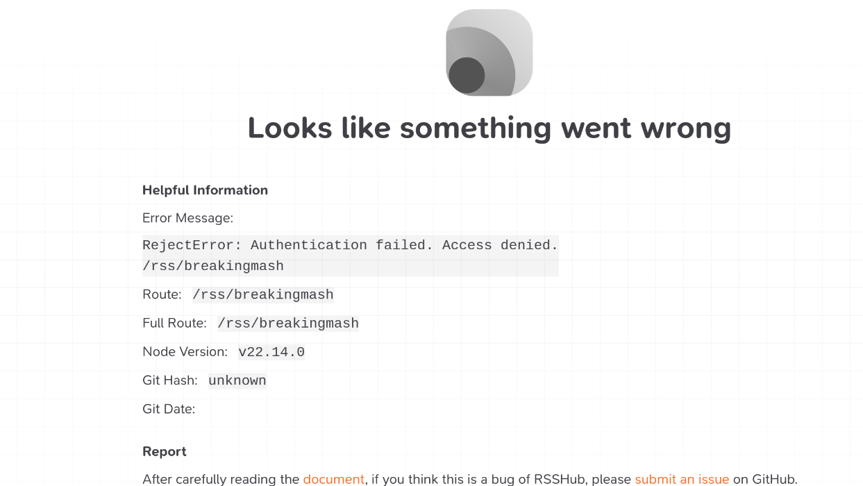

I think it’s configured with a private key right now, and it won’t work without it. I’m not that experienced with how the app works but please let me know how I can share the key with those who may need it.
it looks like it needs some token or authentication
You can append to the URL ?key=z6RL9cHSCSXo9NHJ5zCscFIEX
