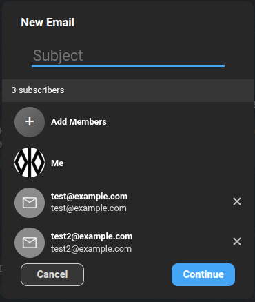

It is possible, but only for “classic” (non-Chatmail) profiles (e.g. Gmail):
Ugh, I didn’t quite get this at first. So now I did some testing, and indeed it works! However, when the mail-account(s) respond with a mail, that won’t land in the original group, right? At least it didn’t in my test. Is there a way to make that work, too? I’m checking for alternatives to WhatsApp with “normal” people …
And thanks a lot for your reponses!
I am pretty sure that this should work, as long as the email is a proper “reply”. I’m not completely sure what qualifies as such. Probably the In-Reply-To header or the email subject.
Well, I tried, original message ID from delta chat and In-Reply-To header (from Evolution) were identical but the message did not land in the group in Delta-Chat, but in a DM Chat with the user with that Email address …
Ugh, nope, you’re right, it works. Evolution did not send to another email address of mine (in spite of reply-all, trying to be too cleaver here), so that it correctly did not go into the group. But after adding that other address (which is also in the group for testing), it works. This could just maybe legit work.
