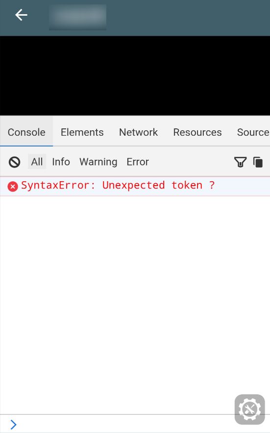

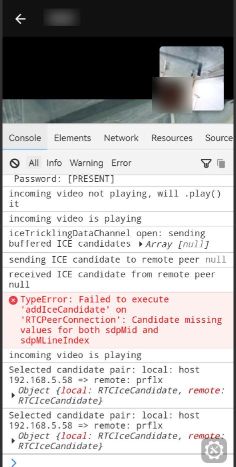

I have tested the above devices. Among them, devices 1, 2, and 3 can make video calls normally. Device 4 can also complete the call but still reports an error.

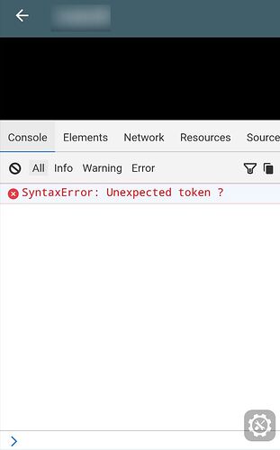

Device 5 shows a completely black screen on the call interface without any buttons, making it impossible to make a call at all.

It seems that even under the same Wi-Fi network, the connection setup takes a relatively long time (except for Device 2, which always establishes connections very quickly). It feels like it takes around 30 seconds, so there might be room for improvement.
