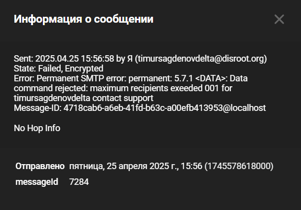

I cannot send messages to anyone from my both devices
I cannot send messages to anyone from my both devices. When I try to do, I get an error:
Sent: 2025.04.25 15:56:58 by Я (timursagdenovdelta@disroot.org)
State: Failed, Encrypted
Error: Permanent SMTP error: permanent: 5.7.1 <DATA>: Data command rejected: maximum recipients exeeded 001 for timursagdenovdelta contact support
Message-ID: 4718cab6-a6eb-41fd-b63c-a00efb413953@localhost
No Hop Info
My account is registered on Disroot.org.
1.56 for Windows
1.58 for Android
Sending a message.
No sending a message TT_TT
  1. Send a message
  2. Open a error message
Debug logs
Logs

That error is server side generated from Disroot, like your account is possibly limited.
Can you send a normal email out to another account, via your Disroot account?
I just tested ok with the desktop client and a disroot account, for what it’s worth.
The issue has gone. I think it was caused by my joining to the Delta Chat discussing room and reaching the Disroot’ limit of possible receivers of my messages . The issue appeared after my joining and left after my leaving. I think, it isn’t a coincidence.
Anyway, thank you for the answer.
Disroot support just answered me. The issue was caused by their settings. The email I got from them:
Hi,
Apologies for such late reply. Somehow we missed your ticket. I hope you are still with us though. I added you to the whitelist so that you wont have problems with deltachat.
