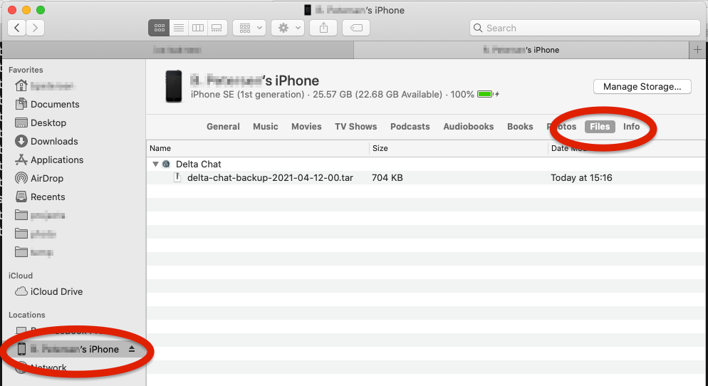

to import a backup on an iPhone:
  • install Delta Chat on the iPhone
  • connect the iPhone to a Mac computer
  • open the Finder on the Mac
  • navigate in the Finder to your iPhone on the left
  • then select “Files” at the top
  • drag’n’drop the backup .tar file to “Delta Chat”
once done, you can disconnect the iPhone from the Mac.
