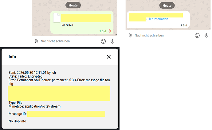

today I’ve tried to send a video with DC, but it failed. The info message showed, that the video is bigger than allowed:
Sent: 2026.02.20 12:42:03 ...
State: Failed, Encrypted
Error: Permanent SMTP error: permanent: 5.3.4 Error: message file too big
File: ..., name: video_2026-02-20_11-42-03.MOV, 45655879 bytes
Type: Video
Mimetype: video/quicktime
The relay I’ve used was nine.testrun.org, so first I’ve checked the info page about restrictions: nothing about maximum message size. Same for other relays I had a look at.
The error indicator is a small red dot with “!”. I did not notice it at all.

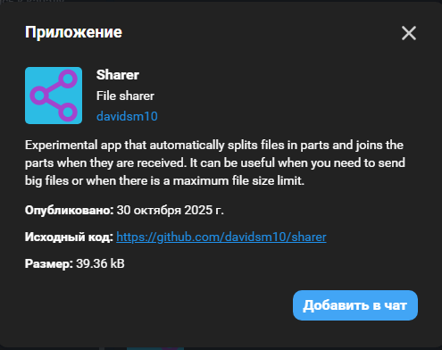

In the “+” attachment menu, under “Apps”, you will find an app to split your file up, send it in chunks, and join up the chunks again. It is called “Sharer” and was written by @DavidSM100 .

Hi, I’ve tried the Sharer app ant it works so far, but:

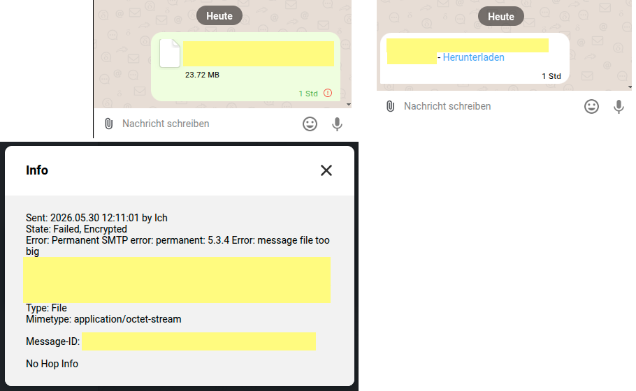

If you set up two Delta users and try to send a ~24MB file the recipient just sees a download button which can do nothing.
