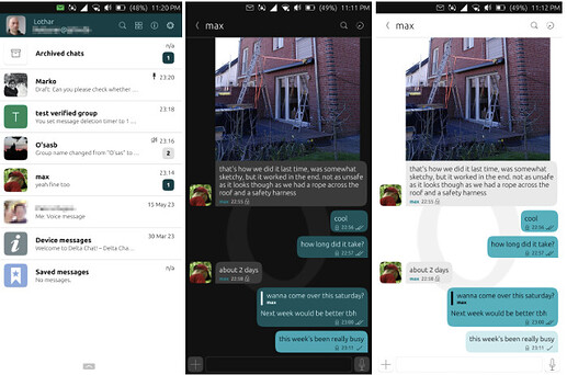

solved! :tada: Delta Chat is available for UbuntuTouch now, linked directly from the official download page.
this is a community-driven effort, see the following blog post for details:
