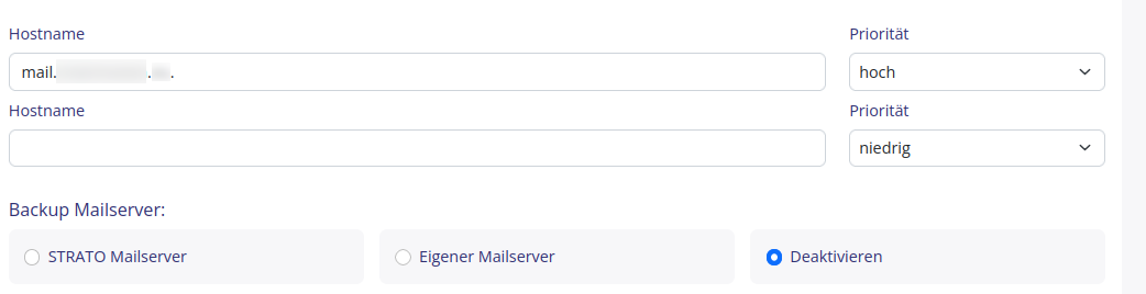

This is what I see in my MX-Record panel:

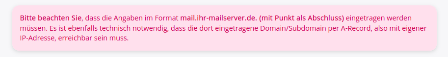

That is what strato says:
(My domain/subdomain has to be in A-Record with its own IP)
This is strange warning, maybe this is for the “STRATO Mailserver” case where they run the website and their own mailserver for you. Is it possible to ignore what the warning says and just point MX record to the domain without “mail.” prefix anyway? If they don’t prevent it, this is the right thing to do, this way incoming mails will be sent directly to your server at port 25.
Well this was no warning but part of the instructions for setting the MX-Record. So if you say it is needed to remove the “mail” prefix I will do so and see what is happening.
By the way. I created a test profile and indeed I could not finish creating a chat with a contact of my relay. Let’s see if it works after removing the prefix.
Now it works! Nice, thank you so much that you tested the mx-record! So much appreciated!

Normally chatmail relay with a domain example.org gets a TLS certificate for example.org, mta-sts.example.org and www.example.org. If you point to your server with MX record saying mail.example.org and point mail.example.org to example.org with CNAME or directly with IP address, the other relay will connect to your server and expect mail.example.org in TLS certificate and this is why it failed before.
