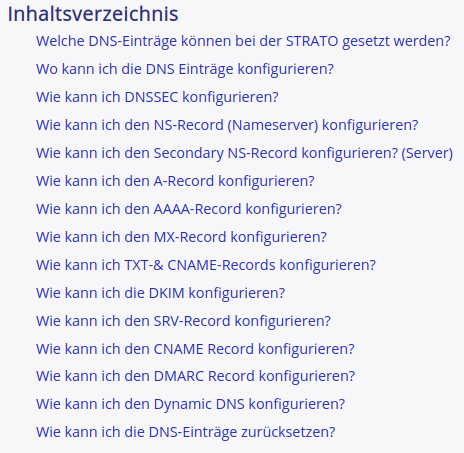

The report is basically saying you have almost nothing configured in DNS, so I would take this as a more serious failure rather than a light warning. Looking up your zone, it uses rzone.de which is owned by strato.de; I do not read German but I think this is the doc with how to use their DNS control panel:
The settings being reported missing are kind of important to how modern email delivery in general works, you’re missing almost all of them.
