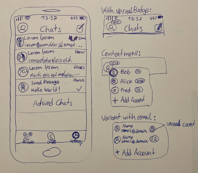

Screen design/concept sketch

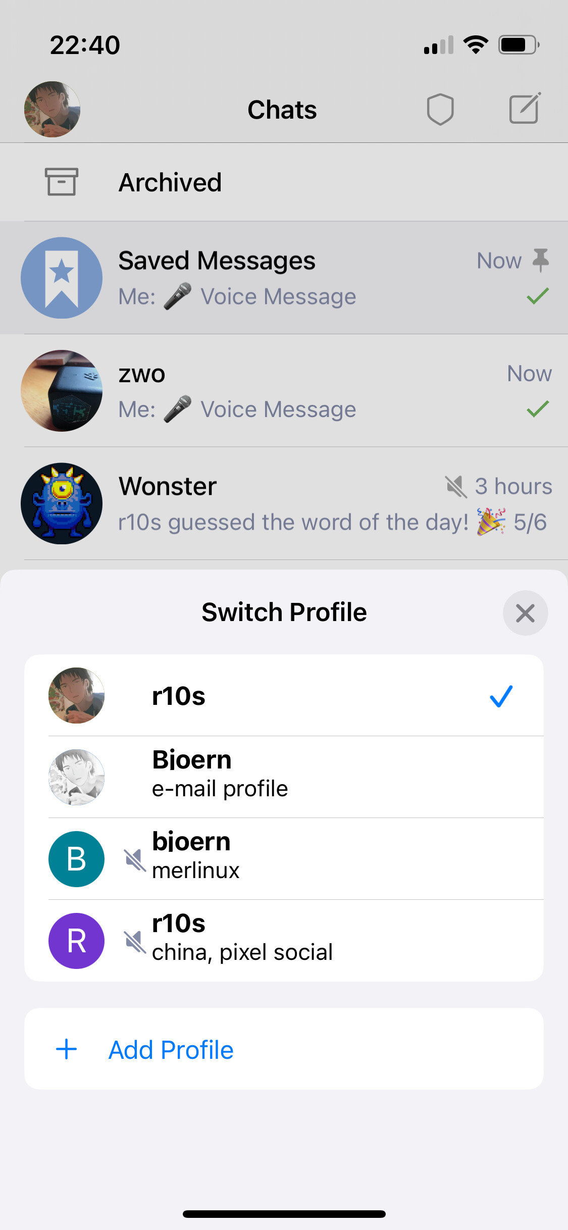

Telegram on iOS, they show this quick switch context menu.

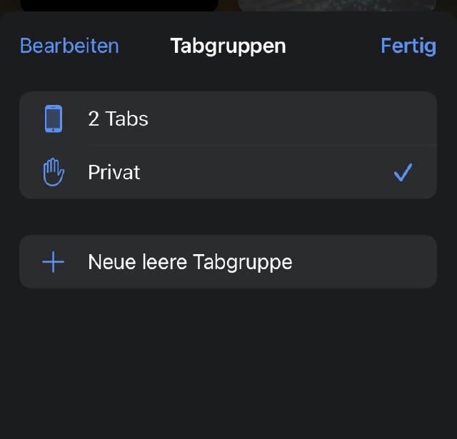

Safari on iOS has a menu that we could also replicate, using it would solve the “making it harder to delete account by accident” issue":

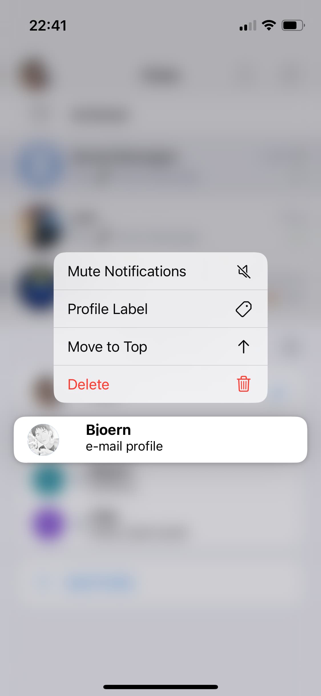

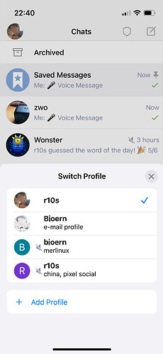

ftr, meanwhile all systems have a more advanced profile selector that targets all ideas in the original post - and even more, eg. iOS:
