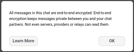

One chat has a message saying that messages are end-to-end encrypted in the beginning:
Clicking on the message brings up this dialog:
Clicking on the “Learn More” brings up this section of FAQ which also describes the meaning of the envelope: FAQ - Delta Chat
Maybe it is not sufficient and easy to overlook, but it’s not required to read the forum to understand which chats are encrypted.
