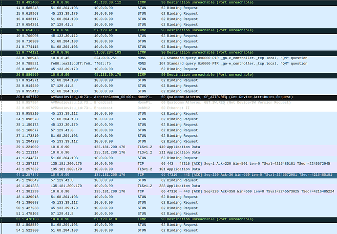

I’ve done as told and let tcpdump record a short period of net traffic. I must admit I cannot read much out of it due to my incompetence but maybe for someone of you it’s trivial. (hope so) I made a screenshot of what I think looks promising because .pcap is not supported to be uploaded.

I’m surprised by all those STUN requests repeating, though. Could you please check over a longer interval whether it is happening continuously and whether it’s always these IP addresses? Hopefully someone is not scanning the world jumping through you.

I mean, sure, some of your users will check in from time to time as they use real time P2P within DC, but seeing it repeated every second sounds fishy. At a minimum, it could be a bug in DC/CM
IPs like 45.133.39.112 (Turkey) and 51.68.204.103 (UK, OVH hoster) are likely not your users, looks like some bot IPs. Why they send STUN Binding Request is a question, could be that this is somehow related to you using FritzBox and having an IP-based telephony on the same network. Found something that looks related: https://old.reddit.com/r/AskNetsec/comments/7ubvsp/computer_sending_and_receiving_stun_binding/
Could be that 10.0.0.90 (your raspberry pi IP) is configured in FritzBox somewhere as an IP phone?
These are the IPs I found at the last tcpdump. They were constantly doing the binding request.

Oh, now I better understand those ICMP port unreachable errors around it. The attackers might be trying to open and forward each of your ports to hack it.

Why are we so eager to say that these are not legit users? The STUN binding request “spam” can be explained by the fact that your server isn’t responding tho these requests, so the clients keep retrying. Could be either WebXDC real-time users or video call users.
So I wouldn’t be posting the IP addresses publicly.
Also why is the STUN port 62? Did you set it up this way? Why is your server not responding to the requests?
I think 62 is the packet size, not the port.
Why should the server not respond. I tested it. The server responses perfectly well even on calls. Creating a profile works flawlessly. Ergo, they seem illegit (just from the probability point of view). Some of them come from the same IP range where the 4th number seems to change from time to time. As it was told above it’s some kind of fishy.
