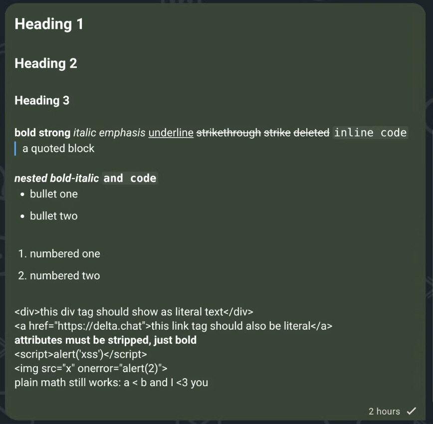

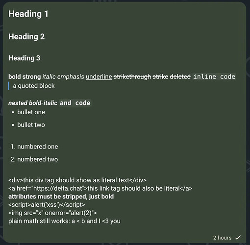

Messages sent as text/html support a subset of HTML. I’ve taken inspiration from how Telegram is doing it, because I think it’s always good to try finding a common way to do things if there’s no reason against it. On the other hand, I think in the beginning we should focus on a small subset, for example:
  • <ul><li></li></ul>
  • <h1>, <h2>, <h3>
  • <b>bold text</b>, <strong>bold text</strong>
  • <i>italic text</i>, <em>italic text</em>
  • <u>underlined text</u>
  • <s>strikethrough text</s>, <strike>strikethrough text</strike>, <del>strikethrough text</del>
  • <code>inline fixed-width code</code>
  • <blockquote>

I have written a simple Proof of Concept which can be seen here: GitHub - JoshuaDietz/deltachat-desktop at html-messages · GitHub Note that the code is NOT yet ready for review, I just wanted to get some feedback on the feature itself first. For the first version I’ve decided to go with a simple approach: When someone enters one of the supported tags, an icon appears where he can toggle between the tags being interpreted as html (new behaviour) or as normal text (old behaviour). Unsupported tags are always shown as text.

As for the text being readable in clients that don’t support HTML, if you send “foo bar baz” in the UI, on the wire a multipart/alternative message is sent with a text part that can say foo **bar** baz and HTML part saying foo <b>bar</b> baz, but there is no need to interpret the text part and know that it is markdown as a receiver.

Thank you all for your feedback. Trying to address everything:
Since I got carried away a little on that one, first a TL;DR; of my main point:
I think we need to approach this in two steps:
  1. Standardize which tags to support, how they will look like when being rendered and establish support for them in as many clients as possible. In this phase the feature is deliberately hidden, i.e. by only being usable if you enter html into the input - but I’m competely open to other approaches like first having to be enabled in the settings. The point is that the rendering side has to be there first before everyone uses the feature. This is the point of my current proof of concept.
  2. A while later, start to roll out an easy-to-use editor that makes these features accessible. Probably WYSIWYG (I really like the signal-example that @link2xt posted) but we could also get with a markdown input (but no markdown transmission, arguments see below). At this point, most clients already support rendering these messages and for the ones that do not, we don’t loose too much.
Here’s my detailed answer:
I’m unsure what you mean by that. To my understanding of what you mean, this is exactly what I’m doing here: If a message arrives as an html message, we render it as html with the deliberate limitation to only support some tags and not the full feature set of html. I think this is the way to go because in the end this should primarily be a chat app that works well on all kinds of devices, especially on phones and not a generic mail client that supports every html feature. If we would go the full html route, this would come with all kinds of problems, i.e. broken layouts, the necessity to allow a zoom feature, complications with other common features (i.e. how would one implement themes if messages can style themselves), text that can be hidden but can come along when copying a message etc etc. That’s why I think limiting it to a subset that all clients can render in a clearly defined way while still sticking with the standard that we use html like emails already do is the way to go.
I think always sending as html when it contains formatting is not the right approach, containing formatting should not be an automatism for sending it as html. But I think with the introduction of WYSIWYG this question will solve itself because by using the WYSIWYG features, the user already communicated his desire to send something with formatting clearly, so this would just be a temporary problem anyway. More on WYSIWYG below.
For the next one it makes sense to batch a few together:
My point of having no UI for now and no WYSIWYG is exactly the compatibility one: We need to FIRST have a clear and standard way how the transmitted data will look like and how it is being rendered. This standard should find its way into all clients BEFORE we start rolling out WYSIWYG features, that make the feature easily accessible. So in the beginning, the feature would only be available for people who already know that it is there and how to use it (i.e. by typing tags into the input) while clients have time to catch up. This will address the compatibility concern. Note that I am also willing to help with other clients than desktop - but I’m not experienced with mobile development.
So to sum it up: The point of the feature is to first establish a standard base-level (meaning a few allowed html tags and how they will be presented visually) of compatibility in as many clients as possible.

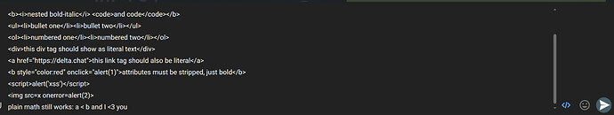

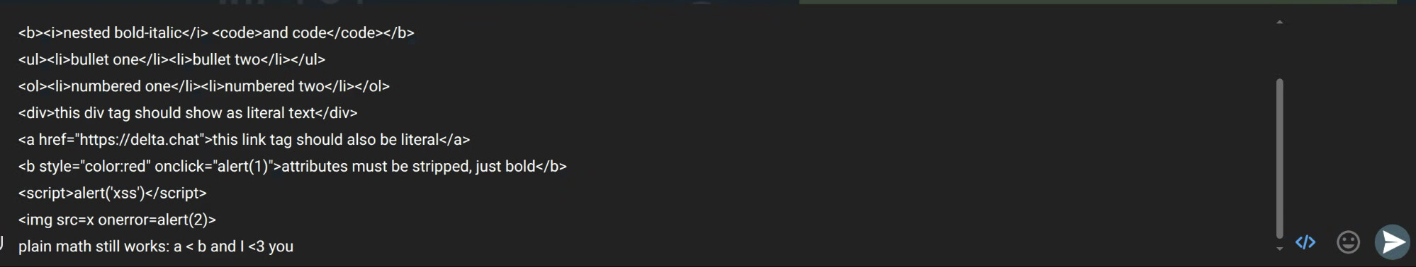

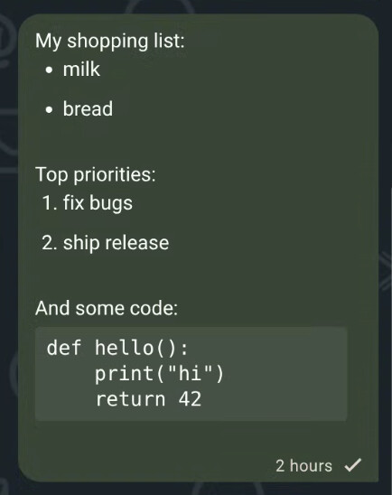

WYSIWYG Editor Proof of concept finished
I finally found the time to build a proof of concept for the WYSIWYG editor how I imagine it. In the comparison you can see the changes excluding the html message changes from before. As before - this code is NOT ready for review yet, but the idea is :slight_smile:
Comparison: Comparing html-messages...html-wysiwyg-editor · JoshuaDietz/deltachat-desktop · GitHub
Features:
Headings, bold, italic, strikethrough, underline, lists, codeblocks, quotes, Fullscreen editing mode, Markdown mode.
Since not everyone has the time to clone my branch and run it himself, here’s a little video where I’ve tried to record all features:
I’ve tried to build the UI in such a way that it makes sense for mobile as well.
As I said before, I think the right approach is to first finalize and merge the rendering part and only when clients had some time to catch up, add the WYSIWYG editor.
You can also see in the recording that there still seems to be a little bug when I try to exit code mode when I type `Esc`, so it’s not perfect yet and there’s definitely still work to do - especially in code cleanup.
