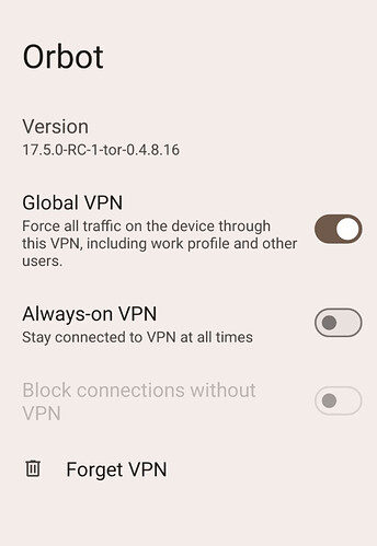

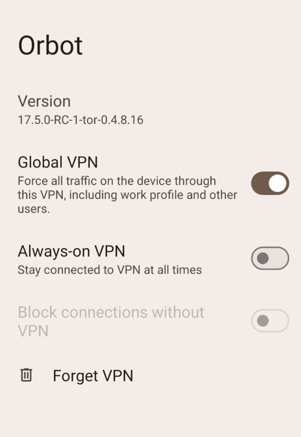

if you have a system VPN, there is no way ArcaneChat can bypass your VPN, anyways, I went to the Orbot VPN settings in the system and enabled “Global VPN”, I guess that is what you want? and it still works fine, this is what I enabled:

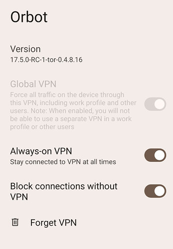

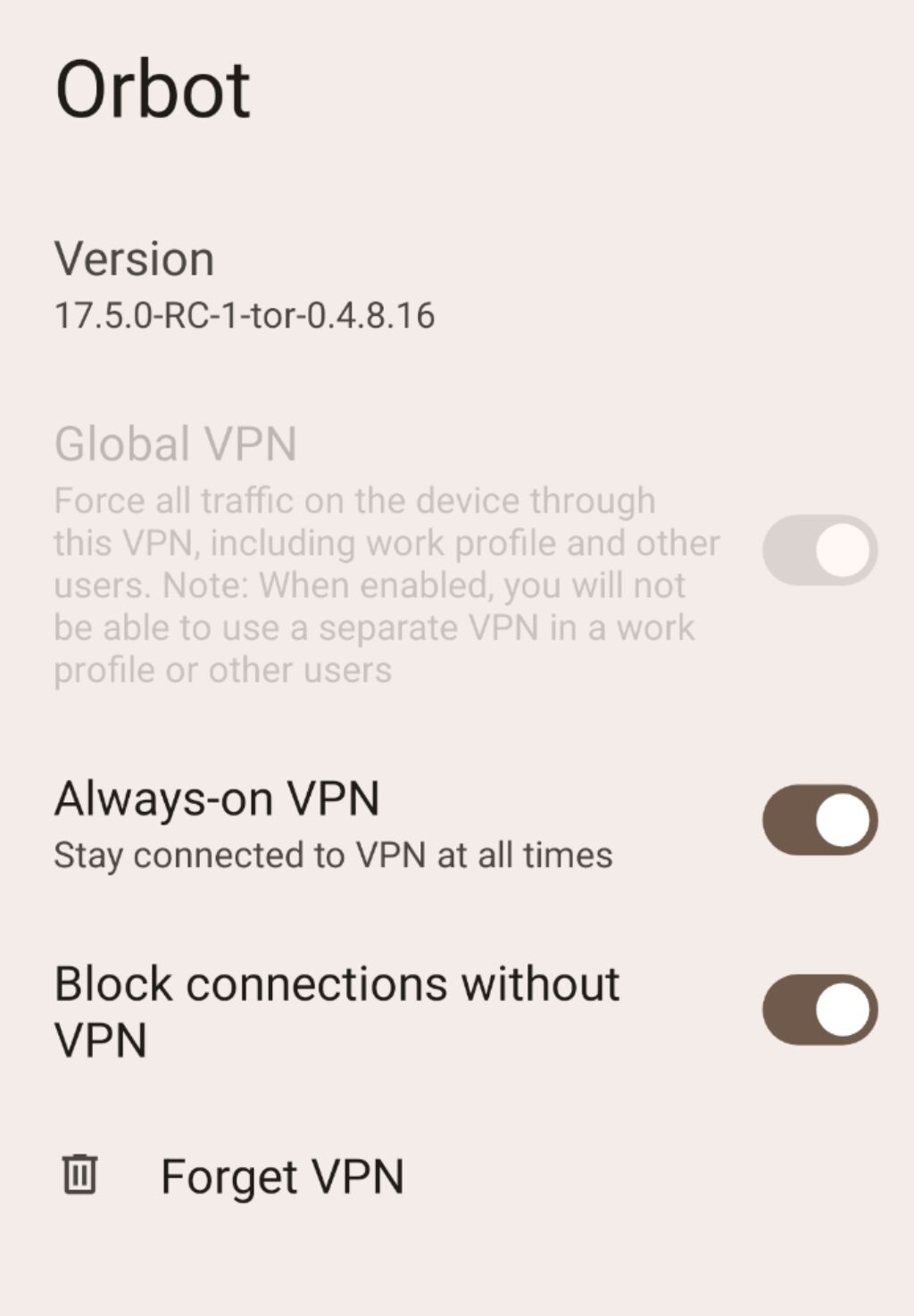

UPDATE: actually the option was right below :sweat_smile:, I enabled it, still ArcaneChat connect fine, I checked that if I stop orbot, then arcanechat can’t connect, so the system setting is being enforced:
