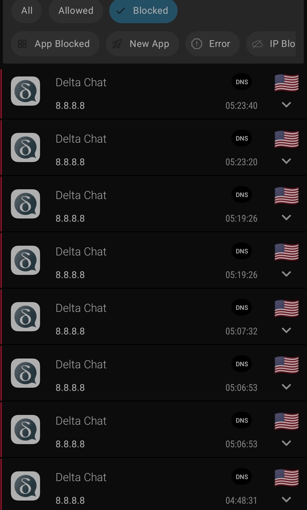

Why connection to GoogleDNS 8.8.8.8
I am using DeltaChat with my own Domain (NetCup).
All my Friends are using my Domain, no Gmail.
On my Android Smartphone is RethinkDNS installed.
In the logs is Deltachat shown with connetions to 8.8.8.8
Does anyone know, why it connectes the Google DNS?
Thanks and Greetings!
