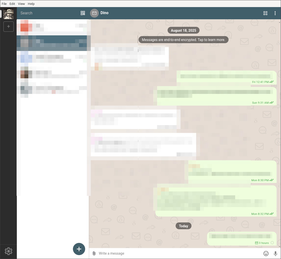

Why did I lose encryption to the user in a secondary chat?
Delta Chat Desktop 2.9.0 (git: v2.9.0-5-g859253929-update-application-config-for-freebsd)
Delta Chat Core v2.9.0
SQLite 3.46.1
electron 35.7.0
node 22.16.0
The git commit is the pull request #5351 to add FreeBSD
On the iOS app, only one chat is visible with all the messages to a particular user
Probably I should have only one chat with the user also on the desktop version?
I have two chats open with the same user (I don’t know why I have two) on deltachat-desktop app.
Two days ago I could send a message to that user (on the newer chat) without any problems.
Today, after reinstalling delta-rpc-server after not using for some time, I noticed that the newer (second) chat has an envelope and “no encryption”. I cannot send the messages due to this:
644.9s [w]core/event: 1 src/mimefactory.rs:335: Missing key for *****@nine.testrun.org
Sending via the older (first) chat seems to be fine.
Why did the chats diverged and why one stopped working?

Having one unencrypted chat for address-contact and zero or more encrypted chats with the key is expected in 2.x. Except that you somehow don’t have a key for the contact. Receiving a message from this contact with attached key should help and make encrypted 1:1 chat usable.
Why did the chat was encrypted until last Monday, August 18th? The messages got sent and received as shown on the screenshot below:
This is very confusing! Some other contact has a single chat only.
