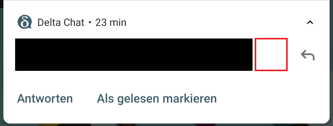

So my question is: Does anyone of you two mark the message as read with the function displayed in the Android popup message notification? (Not within the client UX!)

Unfortunately I do not know, where in the client I even could select “Mark as read”. Is it available in the Android client? In which view should I find it? In the list of chats or within a special chat?
I have it installed with german language. But I don’t see any menu point, I would translate as Mark as read
What is the “message pop up”, where as You write I should be able to set the message to “Mark as read” ? I guess I have not enough traffic with DC up to now, so I am not that experienced.
As I wrote, in the Android message popup notification. There are two buttons available, “Reply”, and “Mark as read” (in German: “Antworten”, and “Als gelesen markieren”).

I mean this message popup:
Hi @gerryfrancis ,I’ve never seen this pop-up-window popping up on my smart phone’s display.
So: No I haven’t made at tick at “Als gelesen markieren”
But maybe your chat partner did it, which might be your cause of not getting double-checkmarks.
@gerryfrancis : As I never saw this window, could You please pose to me, the process sequence of the pop-up-message box, to whom it is offered at which state and what are the consequences of ticking “Mark as read” on both sides of the communication?
(to me it doesn’t make sense, why this pop-up-window might appear at the sender’s display, offering the option “Mark as read”)

  • When the message is received on the device of your Delta Chat contact, the popup appears on the screen.
  • Your contact taps on “Mark as read” (“Als gelesen markieren”). Delta Chat should send a read receipt back to your mail address, which should be the confirmation for your Delta Chat client that your contact read the message. (However, there might be an issue with this function.)

The popup is no longer offered as soon as the respective chat in Delta Chat is opened. Should there be another unread message(s) in another chat, too, the popup alerts as long as the respective chat has not been opened. Example: You are a member of two different groups, let’s name them “Adam” and “Eva”, and you receive messages in both groups. You receive two alerts that group “Adam” and group “Eva” have new unread messages. You switch to Delta Chat and open group chat “Adam” to read the new messages, so the alert for group “Adam” will vanish at this point. You do the same with group “Eva”, and … You already know the answer…
