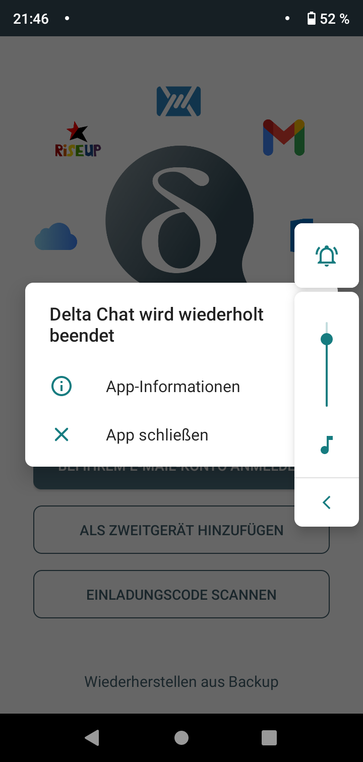

When i statt deltachat i get this screen i have attached.the welcomte to deltachat and the crash/restart prompt over it. Does it mean that f-droid somehow managed to install an older version and all is data is gone or is it usual for the broken 1.40 version to show this? What do you think?
It looks like a broken version 1.40.0 shows the welcome screen and then crashes immediately afterwards. Downgraded version would not crash like this.
