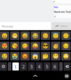

For them it would also be good, if emojis would work in kdeltachat! When I switch the keyboard to emoji the emojis do not appear in the message.
2021-07-05-114938_crop_300
Yes, it’s missing, seems like it should be higher priority than attachments.
