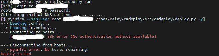

Good day to all!
On the final command “scripts/cmdeploy run” I get this error. Tell me how to fix it so that the installation continues?
Ubuntu 24.03
Ssh-key ed25519 with a passphrase for the key
If you don’t want to remove passphrase from the key, use ssh-agent and add the key to ssh-agent before deploying using ssh-add.
I’ve figured out the ssh key. However, I’m still unable to execute the “scripts/cmdeploy run” command, and my DNS records are resolving properly. UFW is not active. I suspect that my test VPS from Russia is unable to access the Delta Chat frontend, correct? Additionally, I’d like to know how Delta Chat relay is handling the blockages in Russia. I would appreciate your response.

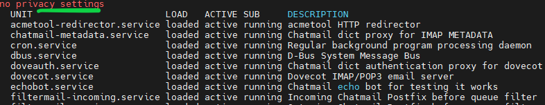

2. “No privacy settings” - what does this mean?

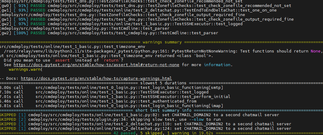

3. When I run “scripts/cmdeploy test”, I get 5 missing, is that normal?

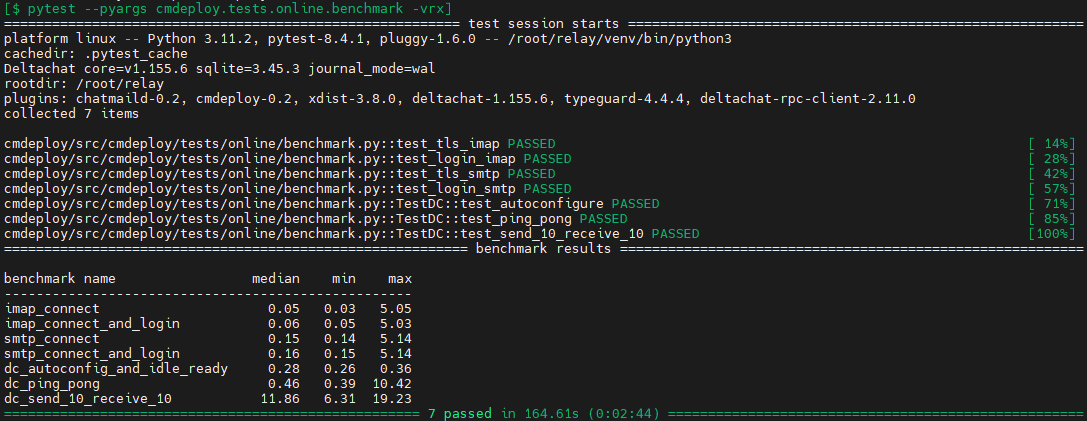

4.Running “scripts/cmdeploy bench” runs without any problems, and the test values are normal.
If you are on unix system, or have unix tools installed - go to your chatmail/relay source dir and execute:
grep -H -n -r -i -C4 --exclude-dir='.git' 'No privacy'
In short, it will search for text ‘No privacy’ in script files.
Result will be:
cmdeploy/src/cmdeploy/cmdeploy.py-149- if args.config.privacy_mail:
cmdeploy/src/cmdeploy/cmdeploy.py-150- out.green(“privacy settings: present”)
cmdeploy/src/cmdeploy/cmdeploy.py-151- else:
cmdeploy/src/cmdeploy/cmdeploy.py:152: out.red(“no privacy settings”)
So, now you get that this warning depends on some privacy_mail argument, Search for it:
grep -H -n -r -i -C4 --exclude-dir='.git' privacy_mail
Results:
chatmaild/src/chatmaild/config.py:54: self.privacy_mail = params.get(“privacy_mail”)
www/src/info.md-34-If you have any further questions or requests regarding account deletion
www/src/info.md:35:please send a message from your account to {{ config.privacy_mail }}.
cmdeploy/src/cmdeploy/cmdeploy.py-148- out.green(f"chatmail domain: {args.config.mail_domain}")
cmdeploy/src/cmdeploy/cmdeploy.py:149: if args.config.privacy_mail:
www/src/privacy.md:51:E-mail: {{ config.privacy_mail }}
www/src/privacy.md-53-We have appointed a data protection officer:
www/src/privacy.md-252-If you have any questions or complaints,
www/src/privacy.md-253-please feel free to contact us by email:
www/src/privacy.md:254:{{ config.privacy_mail }}
I hope now you know what this warning means, and the way to fix it if needed.
Do you mean ‘5 skipped’ ?
Yes, I’m using Debian 12. In general, as I understand it, these are the default settings, and there’s no need to modify them. Does this have any impact on the relay’s functionality? The same applies to the third screenshot.
Yes, I’m confused by the single error and the five missing entries in the screenshot.

Cause of that error is probably a bug in the script.
For tests that where skipped on your screenshot, try to run
CHATMAIL_DOMAIN2=nine.testrun.org cmdeploy test --slow
