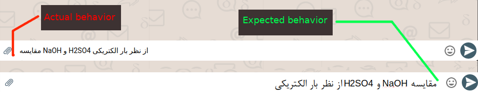

In Persian (and other RTL Languages) sometimes you need to type mixed sentences with both RTL and LTR languages(ٍEnglish for example) and that’s when you need right to left support or everything will get mixed up.
And for the record in RTL languages, every sentence starts from Right
Since even this Topic section does not support RTL i used images(I’m not allowed to use more than one image):

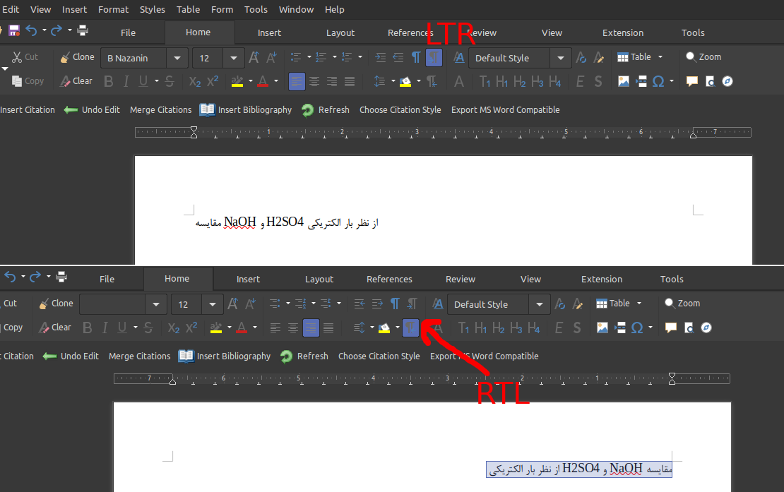

other applications(for example Libreoffice) use an RTL option that can be activated if needed.
Thunderbird has an extension (BiDi Mail UI) for that.
LibreOffice:

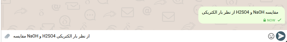

and i should say this problem only exists when you are typing the massage look at this example:
as you can see the massage becomes RTL after it is sent.

this is the test string:
مقایسه NaOH و H2SO4 از نظر بار الکتریکی
it should be like this(typed from end to beginning):
از نظر بار الکتریکی H2SO4 و NaOH مقایسه
