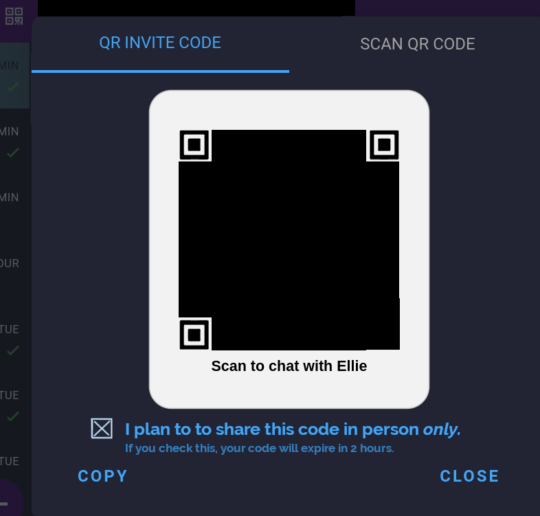

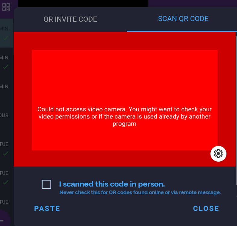

Receiver side: The scan dialog should contain a check box “I scanned this code in person” that defaults to UNchecked.

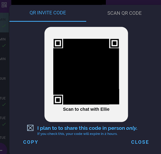

Sender side: The create code dialog should contain a check box “I plan to show this code in person ONLY” that defaults to checked. 1. Codes created with this UNchecked will on the receiver side hide the “I scanned this in person” and force it to be unchecked. 2. Codes with this checked are single use and expire after 2 hours.
  1. Only checked on both sides will lead to a verified checkmark, otherwise a basic lock icon.
  2. If I scan a more trusted code checked on both sides later, it’s upgraded to a verified checkmark.
  3. If I go into the profile of a user and click some “I found out I received a tampered QR code from this person” button, it is downgraded to a basic lock on both sides.
  4. Both lock icon and checkmark will track and alert of sudden crypto key changes anyway.

Mockup suggestion, including the default states. (If you want a paranoid UI, default to unchecked on both sides instead.)
Group codes should have no checkbox and behave as if unchecked.
Unchecked on either end = padlock icon. (Key changes still should cause a big alert, like current e2ee.)
Checked on both ends = verified checkmark.

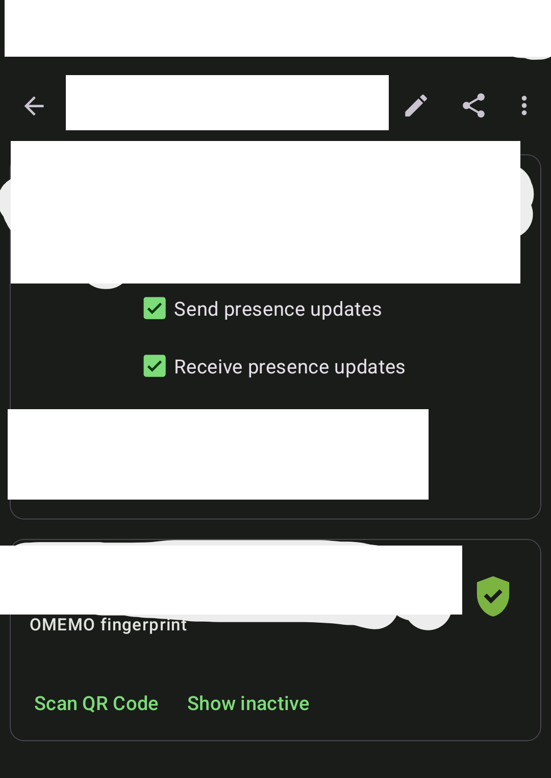

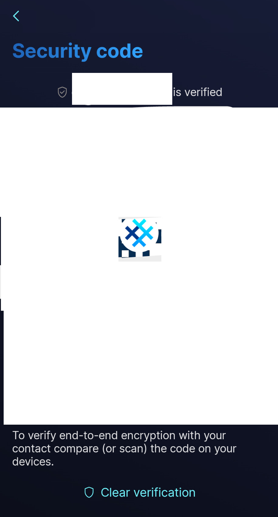

Maybe there should be an option like in Conversations or Simplex to verify users?
Your proposal is already covered by the regular QR scanning when using my proposal. If a user checked “I scanned this code in person” then no additional verification is ever needed. If a user didn’t check it, then your additional verification-in-retrospect proposal might come in play, but instead they could just meet up and repeat a regular QR scan but then check “I scanned this code in person”.
