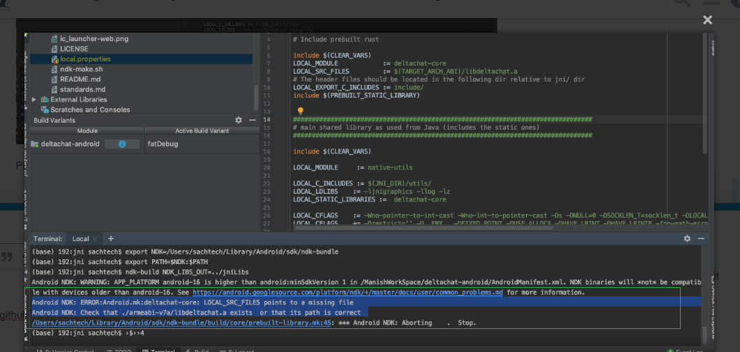

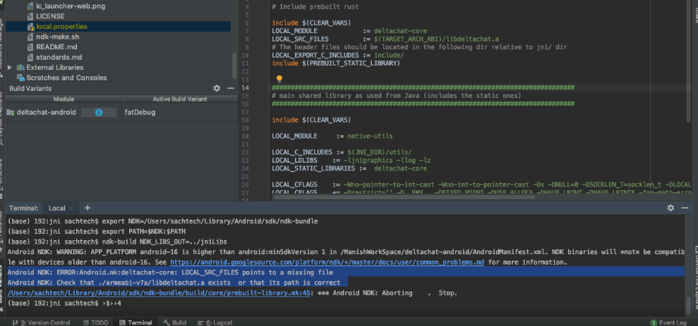

Hello Support,
I am Unable to generate apk from android source code from github, it is saying file missing. Please refer attached screenshot.
Please suggest why I am getting that.

I have updated the screenshot. I have followed all those link to compile only.

it seems the libraries generated by ./ndk-make.sh are not there or cannot be found.
i would first check, after executing ./ndk-make.sh (not: ndk-build) manually from the command line, that the files
./jni/armeabi-v7a/libdeltachat.a
./jni/x86/libdeltachat.a
./jni/arm64-v8a/libdeltachat.a
./jni/x86_64/libdeltachat.a
exist and have several megabytes as file size. Android Studio is not needed at this point at all.

I am using - GitHub - deltachat/deltachat-android: Email-based instant messaging for Android. master commit. Please see below screenshot.
Master is the branch, commit is https://github.com/deltachat/deltachat-android/commit/b11f293dfd46ed22ab17d2b8b54c259c2587a0af whose reduced code is (in this case) b11f293
