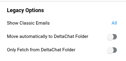

It may be unobvious that the "Deltachat" folder use case is going away (update: is apparently still being looked into)
I only realized by accident in the “Advanced” menu that 1. “Only Fetch from DeltaChat Folder” is marked as a “Legacy Option”, and 2. even from that wording it wasn’t entirely obvious to me it was going away soon. Important update: read the latest messages in the thread, it’s not decided yet whether it’ll go away or get migrated to a new per-relay option.
Since this option removal might be catastrophic for some setups, I feel like a more obvious announcement would help. Or is that just me thinking that? E.g. via device messages.
Also, while I’m not telling you to keep the option, without it running DeltaChat may have significant extra cost for some people. (Since most paid e-mail providers, the ones more likely to handle DeltaChat use properly, offer aliases and server-side sorting rules which means “Move into DeltaChat folder” and the “Chat-Protocol” header are optional for mixed DeltaChat use. However, they don’t offer multiple inboxes.)
And without relays and changing the e-mail as options, the migration path is unobvious.
To repeat what this is about: in Delta Chat 2.33 these three options are moved to “legacy options”:
It is also not possible to add second relay (How to migrate your profile to another relay (version 2.33)) when these settings are set to non-default value because we want to eventually remove these options rather than make them configurable per-relay.
The reason for deprecating these options is that changing them away from the defaults shown in the screenshot is only useful for “shared mailbox” usecase where you use Delta Chat together with another email client that cannot handle chat messages (because it does not have the decryption keys, because it notifies about outgoing messages Bcc-ed to self, because it displays chats as very wide “ladder” threads etc.). If your other client can handle the amount of messages Delta Chat produces, you can keep using such setup with Delta Chat using your inbox. Otherwise, we recommend migrating Delta Chat to use a separate inbox.
