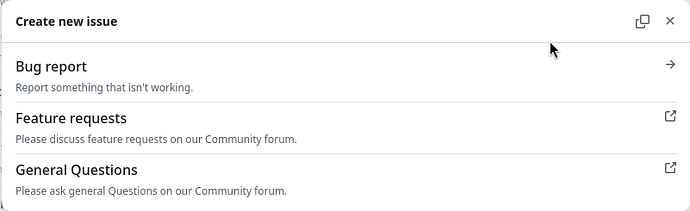

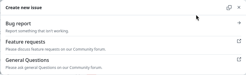

Delta Chat Android issue tracker is a backlog of tasks that are already agreed to work on or bug reports. Bug reports are fine to file directly there. Feature requests however should be filed on the forum.
When you click on a “New issue” on GitHub, the first thing you should see is this:
If you click a “Bug report”, it is automatically tagged with a “bug” and there is this text at the top of the template again redirecting to the forum:
This is a bug report tracker. New features are discussed in the forum: https://support.delta.chat
Please fill out as much of this form as you can (leaving out stuff that is not applicable is ok).
If you are sure something is a bug or regression, it is fine to file it directly into the issue tracker, but then at least the version should be specified, see the rest of the template.
