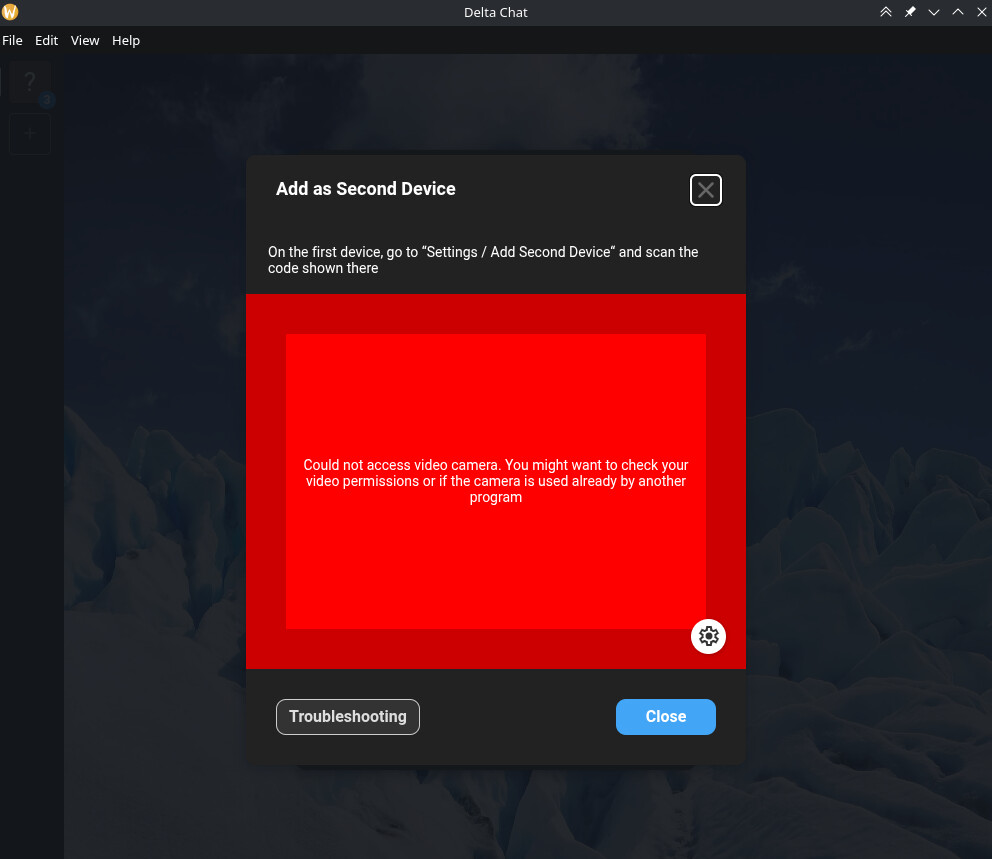

I want to add my desktop that does not have a camera no WiFi, and it is on an isolated cable-only network, as the secondary device to my mobile DeltaChat client. It seems both camera and WiFi are hard requirement, but majority of the desktop computers I have encountered during the past 38 years do not have a webcam nor wifi interface.

My computer does not have a camera (and no WiFi either, which is another requirement here). so I get the error in the screenshot section.
no, they are not hard requirements.
setting up second device without a camera and without wifi is described at FAQ - Delta Chat (linked via “Troubleshooting” button)
if you have wifi, but no camera, you can also try to copy+paste the QR code
