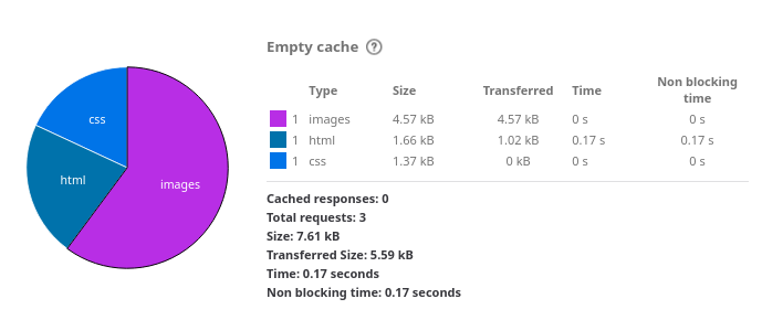

as I see it, this is what we’re talking about
For nine.testrun.org it’s also instant for me, the page opens in way less than a second:
