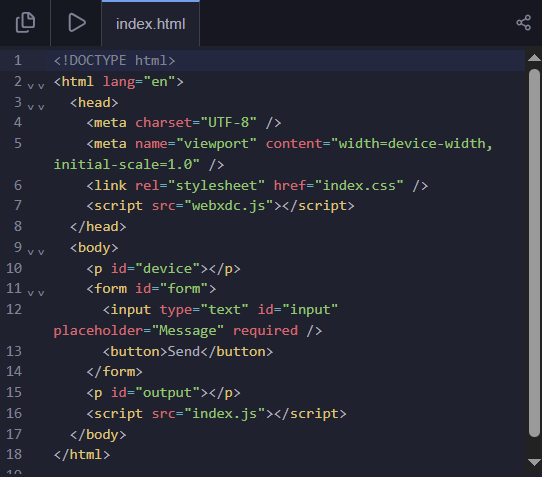

Another idea: something like an IDE that can generate .xdcs, I’d say similar to codepen.io, jsfiddle.net, codesandbox.io .
I think it’s a great way to play around with WebXDC - you wouldn’t have to install a bunch of tools to get started, and you could even do it on your phone.
Update 2025-12: @DavidSM100 has done it: GitHub - DavidSM100/webxdc-code-playground: Webxdc that allows you to code, preview and build a webxdc.
Download.
Code editors can get big, so not sure how much of an IDE can be fit into our webxdcs with the current size limit. Though I agree it would be really cool to have a small IDE for webxdc apps.
BTW we can make out templates work well with sites like stackblitz, like this Webxdc - Ionic React Webxdc Starter - StackBlitz so users would not need to install anything, just click on a link…
